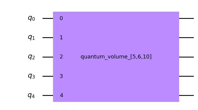

A quantum volume model circuit.
The model circuits are random instances of circuits used to measure the Quantum Volume metric, as introduced in [1].
The model circuits consist of layers of Haar random elements of SU(4) applied between corresponding pairs of qubits in a random bipartition.
Reference Circuit:
../_images/qiskit.circuit.library.QuantumVolume_0_2.png
