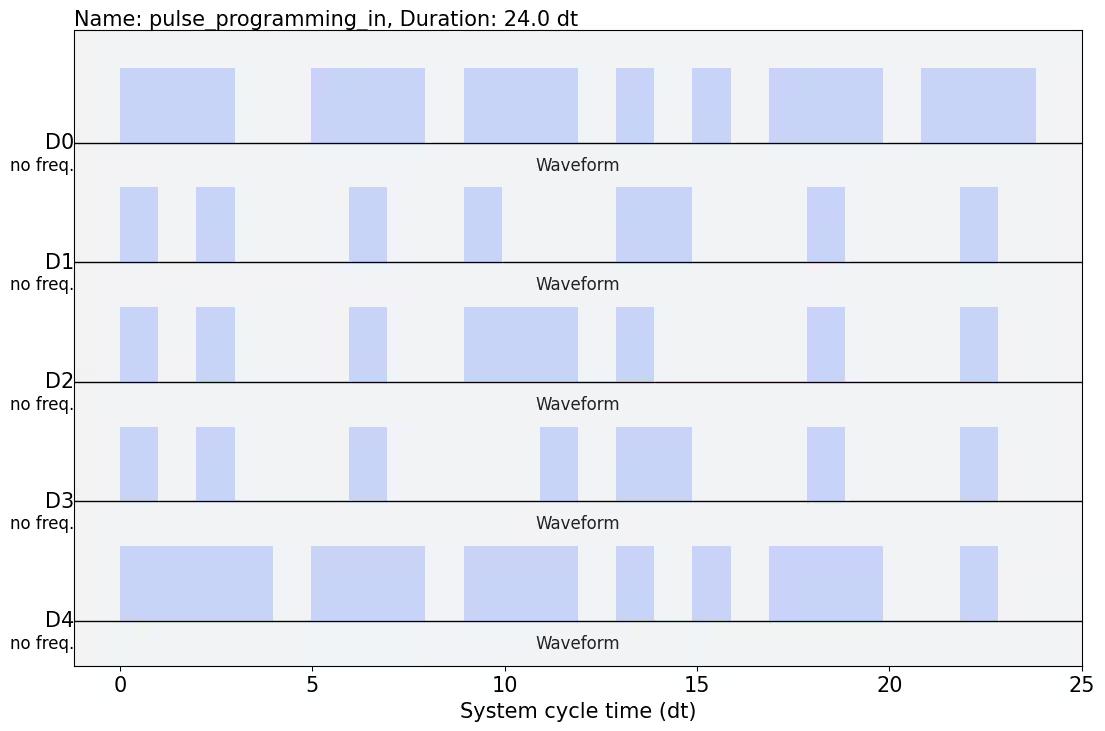

from qiskit import pulse
dc = pulse.DriveChannel
d0, d1, d2, d3, d4 = dc(0), dc(1), dc(2), dc(3), dc(4)
with pulse.build(name='pulse_programming_in') as pulse_prog:
    pulse.play([1, 1, 1, 0, 0, 1, 1, 1, 0, 1, 1, 1, 0, 1, 0, 1, 0, 1, 1, 1, 0, 1, 1, 1], d0)
    pulse.play([1, 0, 1, 0, 0, 0, 1, 0, 0, 1, 0, 0, 0, 1, 1, 0, 0, 0, 1, 0, 0, 0, 1, 0], d1)
    pulse.play([1, 0, 1, 0, 0, 0, 1, 0, 0, 1, 1, 1, 0, 1, 0, 0, 0, 0, 1, 0, 0, 0, 1, 0], d2)
    pulse.play([1, 0, 1, 0, 0, 0, 1, 0, 0, 0, 0, 1, 0, 1, 1, 0, 0, 0, 1, 0, 0, 0, 1, 0], d3)
    pulse.play([1, 1, 1, 1, 0, 1, 1, 1, 0, 1, 1, 1, 0, 1, 0, 1, 0, 1, 1, 1, 0, 0, 1, 0], d4)
pulse_prog.draw()
../_images/pulse_0_0.png

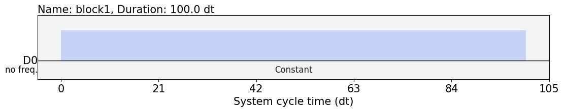

To begin pulse programming we must first initialize our program builder context with build(), after which we can begin adding program statements. For example, below we write a simple program that play()s a pulse:
from qiskit import execute, pulse
d0 = pulse.DriveChannel(0)
with pulse.build() as pulse_prog:
    pulse.play(pulse.Constant(100, 1.0), d0)
pulse_prog.draw()
../_images/pulse_1_0.png
The builder initializes a pulse.Schedule, pulse_prog and then begins to construct the program within the context. The output pulse schedule will survive after the context is exited and can be executed like a normal Qiskit schedule using qiskit.execute(pulse_prog, backend).

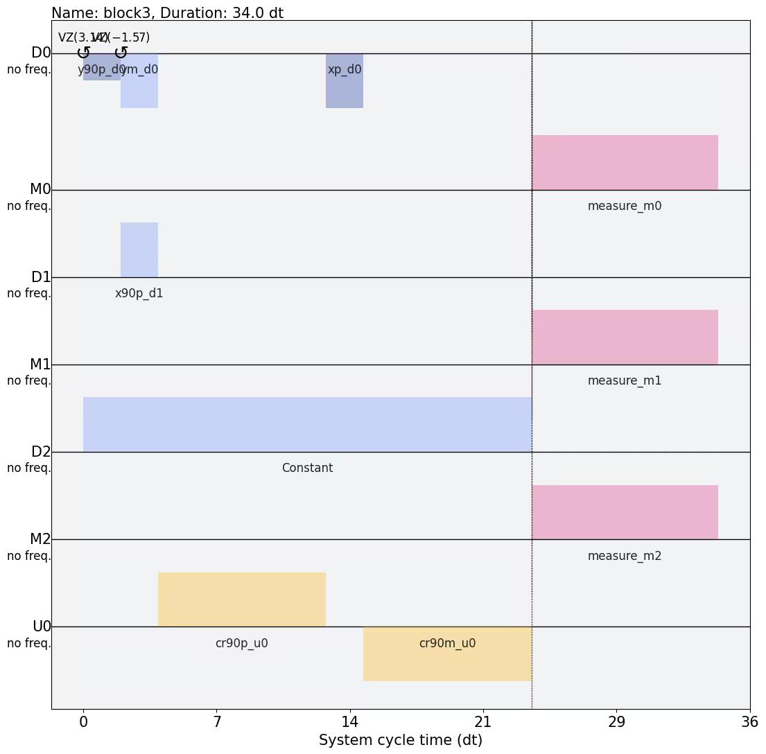

We can optionally pass a Backend to build() to enable enhanced functionality. Below, we prepare a Bell state by automatically compiling the required pulses from their gate-level representations, while simultaneously applying a long decoupling pulse to a neighboring qubit. We terminate the experiment with a measurement to observe the state we prepared. This program which mixes circuits and pulses will be automatically lowered to be run as a pulse program:
import math
from qiskit.providers.fake_provider import FakeOpenPulse3Q
# TODO: This example should use a real mock backend.
backend = FakeOpenPulse3Q()
d2 = pulse.DriveChannel(2)
with pulse.build(backend) as bell_prep:
    pulse.u2(0, math.pi, 0)
    pulse.cx(0, 1)
with pulse.build(backend) as decoupled_bell_prep_and_measure:
    # We call our bell state preparation schedule constructed above.
    with pulse.align_right():
        pulse.call(bell_prep)
        pulse.play(pulse.Constant(bell_prep.duration, 0.02), d2)
        pulse.barrier(0, 1, 2)
        registers = pulse.measure_all()
decoupled_bell_prep_and_measure.draw()
../_images/pulse_2_0.png
With the pulse builder we are able to blend programming on qubits and channels. While the pulse schedule is based on instructions that operate on channels, the pulse builder automatically handles the mapping from qubits to channels for you.

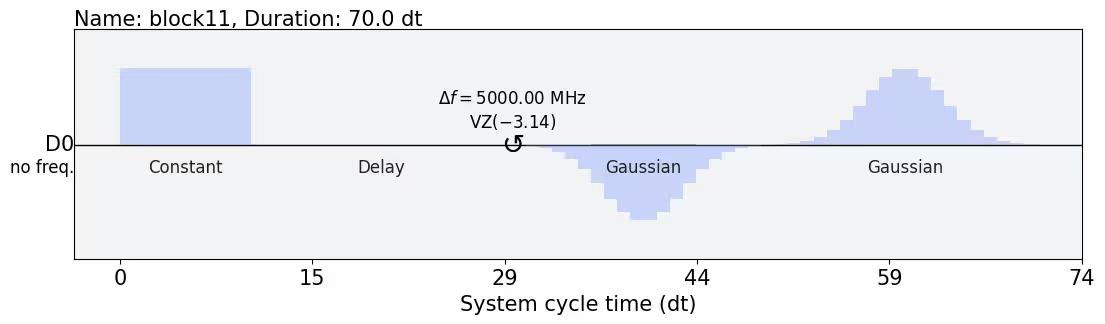

Instructions
Pulse instructions are available within the builder interface. Here’s an example:
from qiskit.providers.fake_provider import FakeArmonk
backend = FakeArmonk()
with pulse.build(backend) as drive_sched:
    d0 = pulse.drive_channel(0)
    a0 = pulse.acquire_channel(0)
    pulse.play(pulse.library.Constant(10, 1.0), d0)
    pulse.delay(20, d0)
    pulse.shift_phase(3.14/2, d0)
    pulse.set_phase(3.14, d0)
    pulse.shift_frequency(1e7, d0)
    pulse.set_frequency(5e9, d0)
    with pulse.build() as temp_sched:
        pulse.play(pulse.library.Gaussian(20, 1.0, 3.0), d0)
        pulse.play(pulse.library.Gaussian(20, -1.0, 3.0), d0)
    pulse.call(temp_sched)
    pulse.acquire(30, a0, pulse.MemorySlot(0))
drive_sched.draw()
../_images/pulse_5_0.png

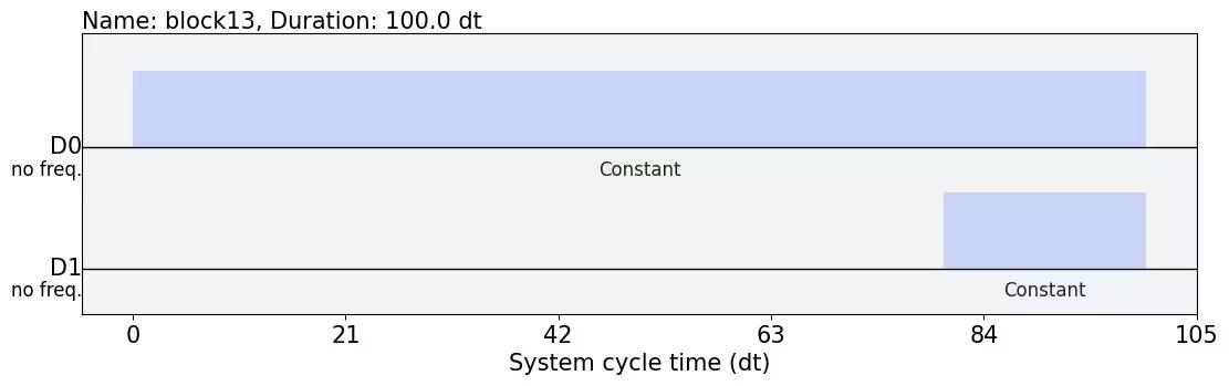

d1 = pulse.DriveChannel(1)
        # this pulse will start at t=0
        # this pulse will start at t=80
        pulse.play(pulse.Constant(20, 1.0), d1)
pulse_prog.draw()
../_images/pulse_6_0.png
