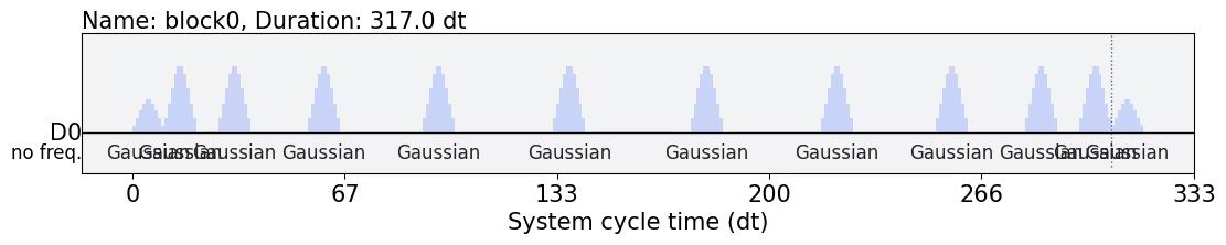

Pulse instructions within this context are scheduled at the location specified by arbitrary callback function position that takes integer index and returns the associated fractional location within [0, 1]. Delay instruction is automatically inserted in between pulses.
This context may be convenient to write a schedule of arbitrary dynamical decoupling sequences such as Uhrig dynamical decoupling.

import numpy as np
from qiskit import pulse
d0 = pulse.DriveChannel(0)
x90 = pulse.Gaussian(10, 0.1, 3)
x180 = pulse.Gaussian(10, 0.2, 3)
def udd10_pos(j):
    return np.sin(np.pi*j/(2*10 + 2))**2
with pulse.build() as udd_sched:
    pulse.play(x90, d0)
    with pulse.align_func(duration=300, func=udd10_pos):
        for _ in range(10):
            pulse.play(x180, d0)
    pulse.play(x90, d0)
udd_sched.draw()
../_images/qiskit.pulse.builder.align_func_0_0.png
