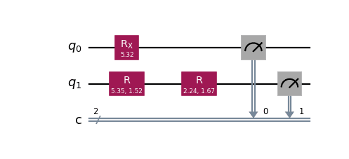

This function will generate a random circuit by randomly selecting gates from the set of standard gates in qiskit.circuit.library.standard_gates. For example:
from qiskit.circuit.random import random_circuit
circ = random_circuit(2, 2, measure=True)
circ.draw(output='mpl')
Circuit diagram output by the previous code.

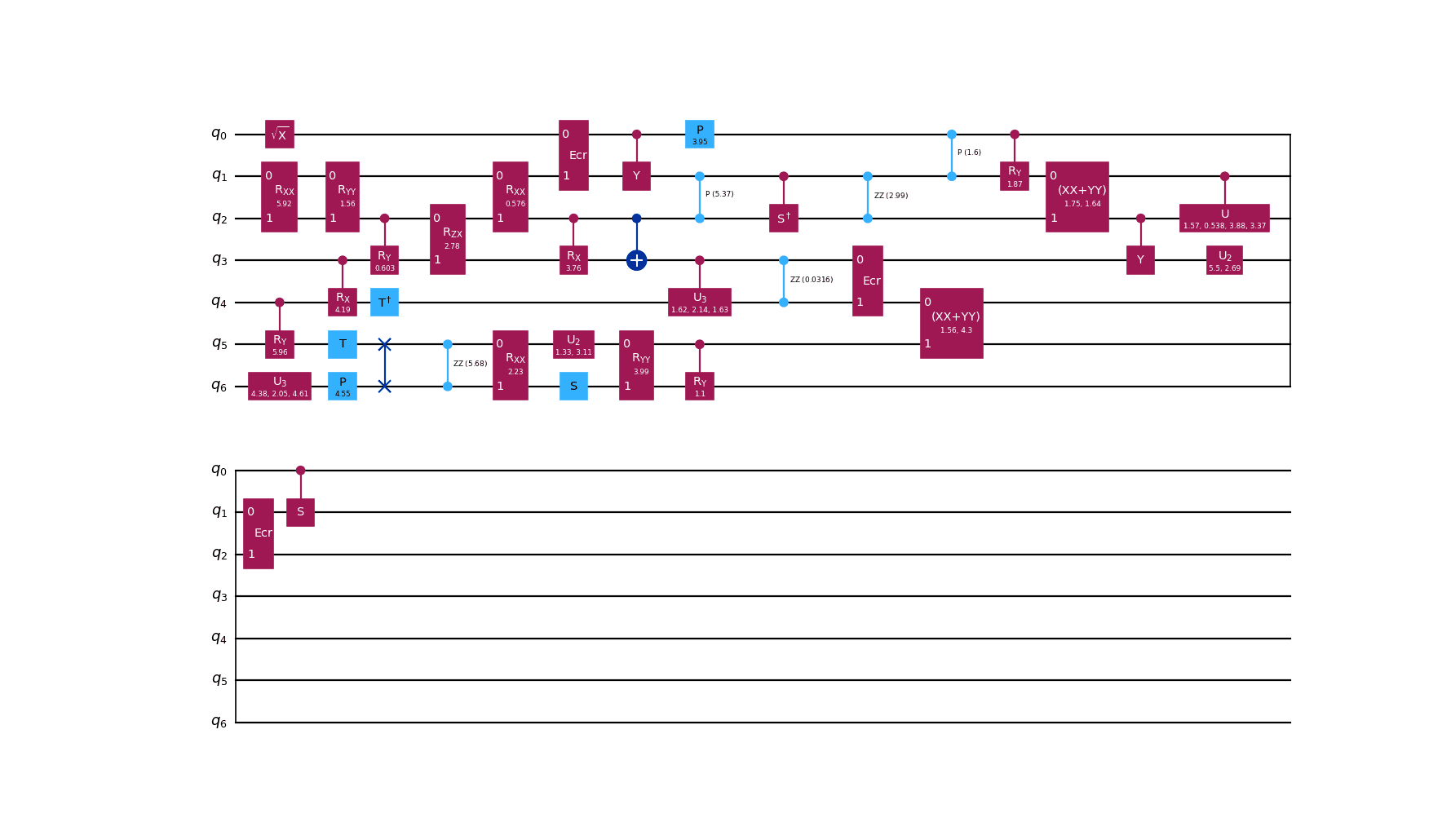

Example:
from qiskit.circuit.random.utils import random_circuit_from_graph
import rustworkx as rx
pydi_graph = rx.PyDiGraph()
pydi_graph.add_nodes_from(range(7))
cp_map = [(0, 1, 0.18), (1, 2, 0.15), (2, 3, 0.15), (3, 4, 0.22), (4, 5, 0.13), (5, 6, 0.17)]
pydi_graph.add_edges_from(cp_map)
# cp_map can be passed in directly as interaction_graph
qc = random_circuit_from_graph(pydi_graph, min_2q_gate_per_edge=2, seed=12345)
qc.draw(output='mpl')
Pass in interaction graph and minimum 2Q gate per edge as a bare minimum.

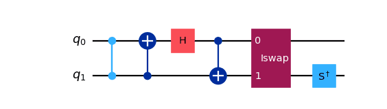

This function will generate a Clifford circuit by randomly selecting the chosen amount of Clifford gates from the set of standard gates in qiskit.circuit.library.standard_gates. For example:
from qiskit.circuit.random import random_clifford_circuit
circ = random_clifford_circuit(num_qubits=2, num_gates=6)
