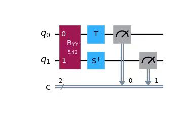

This function will generate a random circuit by randomly selecting gates from the set of standard gates in qiskit.circuit.library.standard_gates. For example:
from qiskit.circuit.random import random_circuit
circ = random_circuit(2, 2, measure=True)
circ.draw(output='mpl')
Circuit diagram output by the previous code.

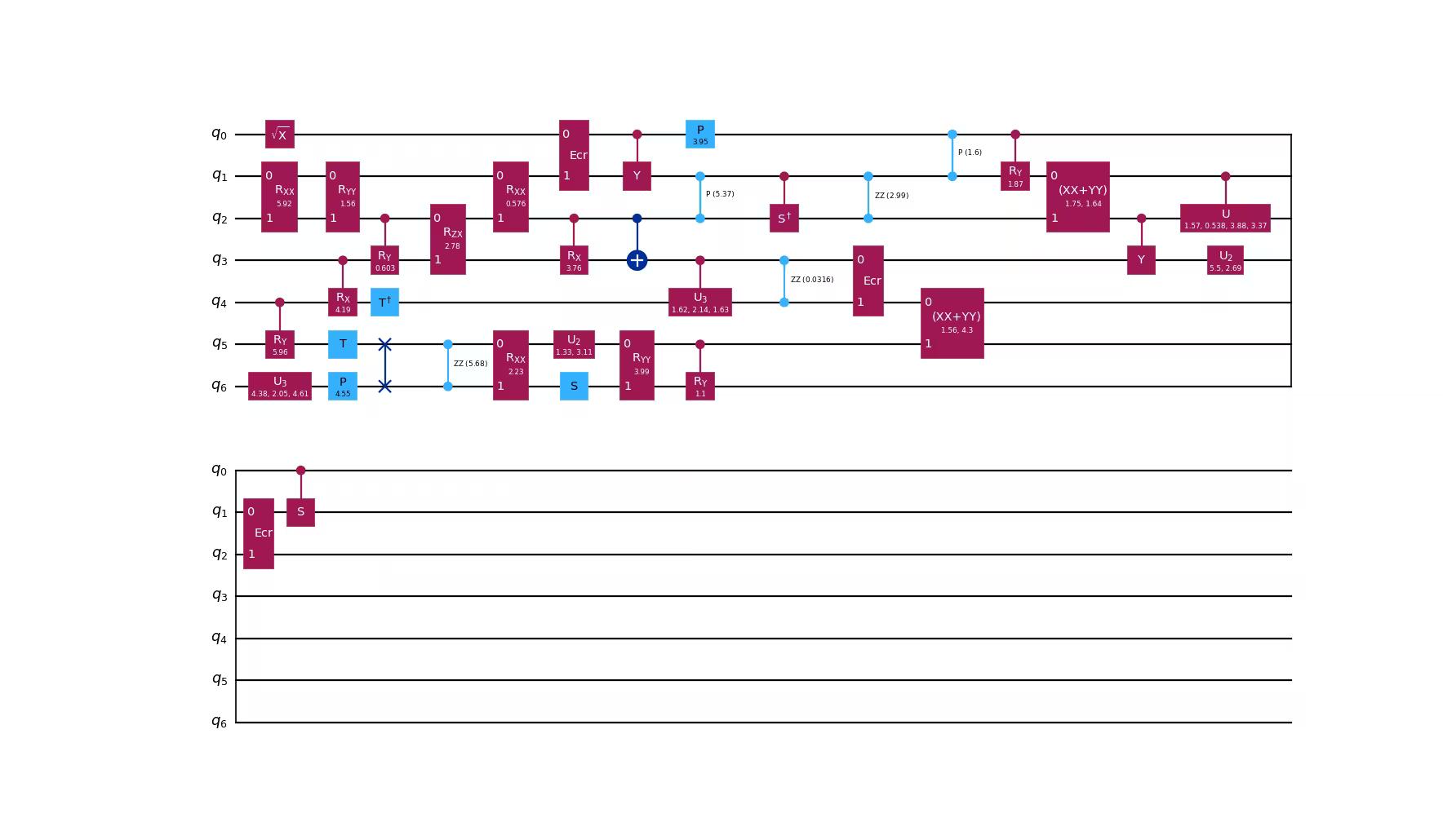

qiskit.circuit.random.random_circuit_from_graph(interaction_graph, min_2q_gate_per_edge=1, max_operands=2, measure=False, conditional=False, reset=False, seed=None, insert_1q_oper=True, prob_conditional=0.1, prob_reset=0.1)
GitHub
Generate random circuit of arbitrary size and form which strictly respects the interaction graph passed as argument. Interaction Graph is a graph G=(V, E) where V are the qubits in the circuit, and, E is the set of two-qubit gate interactions between two particular qubits in the circuit.
This function will generate a random circuit by randomly selecting 1Q and 2Q gates from the set of standard gates in qiskit.circuit.library.standard_gates. The user can attach a numerical value as a metadata to the edge of the graph indicating the edge weight for that particular edge, These edge weights would be normalized to the probabilities of the edges getting selected. If all the edge weights are passed as None, then the probability of each qubit-pair of getting selected is set to 1/N, where N is the number of edges in the interaction_graph passed in, i.e each edge is drawn uniformly. If any weight of an edge is set as zero, that particular edge will not be included in the output circuit.
Passing a list of tuples of control qubit, target qubit and associated probability is also acceptable as a way to specify an interaction graph.
If numerical values are present as probabilities but some/any are None, or negative, when max_operands=2 this will raise a ValueError.
If max_operands is set to 1, then there are no 2Q operations, so no need to take care of the edges, in such case the function will return a circuit from the random_circuit function, which would be passed with the max_operands as 1.
If max_operands is set to 2, then in every while-iteration 2Q gates are chosen randomly, and qubit-pairs which exist in the input interaction graph are also chosen randomly based on the probability attached to the qubit-pair. Then in a for-iteration 2Q gates are applied to the randomly chosen qubit-pairs with the aim to reach the count of 2Q on any qubit-pair to min_2q_gate_per_edge criteria as soon as possible within a particular iteration. Now, if some qubits are still idle after applying 2Q gates for that particular iteration, then randomly chosen 1Q gates are applied to those idle qubits if insert_1q_oper is set to True.
Example:
from qiskit.circuit.random.utils import random_circuit_from_graph
import rustworkx as rx
pydi_graph = rx.PyDiGraph()
pydi_graph.add_nodes_from(range(7))
cp_map = [(0, 1, 0.18), (1, 2, 0.15), (2, 3, 0.15), (3, 4, 0.22), (4, 5, 0.13), (5, 6, 0.17)]
pydi_graph.add_edges_from(cp_map)
# cp_map can be passed in directly as interaction_graph
qc = random_circuit_from_graph(pydi_graph, min_2q_gate_per_edge=2, seed=12345)
qc.draw(output='mpl')
Pass in interaction graph and minimum 2Q gate per edge as a bare minimum.

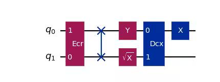

This function will generate a Clifford circuit by randomly selecting the chosen amount of Clifford gates from the set of standard gates in qiskit.circuit.library.standard_gates. For example:
from qiskit.circuit.random import random_clifford_circuit
circ = random_clifford_circuit(num_qubits=2, num_gates=6)
