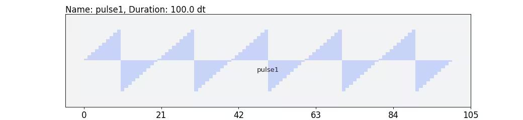

envelope = 2 * amp * (freq * t - sympy.floor(1 / 2 + freq * t))
my_pulse = SymbolicPulse(
    pulse_type="Sawtooth",
    duration=100,
    parameters={"amp": 0.1, "freq": 0.05},
    envelope=envelope,
    name="pulse1",
my_pulse.draw()
../_images/qiskit-pulse-library-SymbolicPulse-1.png
Likewise, you can define SymbolicPulse.constraints for my_pulse. After providing the envelope definition, you can generate the waveform data. Note that it would be convenient to define a factory function that automatically accomplishes this procedure.
