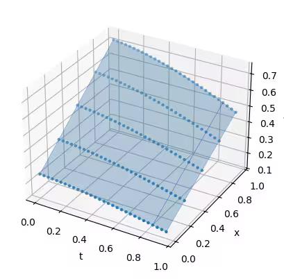

Step 3: Use the result
With your solution, you can now choose what to do with it. The following demonstrates how to plot the result.
solution = job.result()
# Plot the solution of the second simulation job_2
_ = plt.figure()
ax = plt.axes(projection="3d")
# plot the solution using the 3d plotting capabilities of pyplot
t, x = np.meshgrid(solution["samples"]["t"], solution["samples"]["x"])
ax.plot_surface(
    t,
    x,
    solution["functions"]["u"],
    edgecolor="royalblue",
    lw=0.25,
    rstride=26,
    cstride=26,
    alpha=0.3,
ax.scatter(t, x, solution, marker=".")
ax.set(xlabel="t", ylabel="x", zlabel="u(t,x)")
plt.show()
Output:
Output of the previous code cell

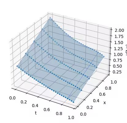

Notice the difference of initial condition for the second run and its effect on the result:
solution_2 = job_2.result()
_ = plt.figure()
t, x = np.meshgrid(solution_2["samples"]["t"], solution_2["samples"]["x"])
ax.plot_surface(
    t,
    x,
    solution_2["functions"]["u"],
    lw=0.25,
    rstride=26,
    cstride=26,
    alpha=0.3,
ax.scatter(t, x, solution_2, marker=".")
plt.show()
Output:
