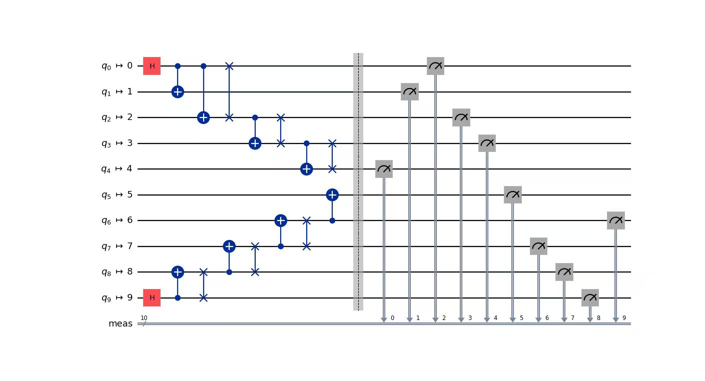

This pass is a logical optimization pass that rewrites any solely 2q gate star connectivity subcircuit as a linear connectivity equivalent with swaps.
For example:
from qiskit.transpiler.passes import StarPreRouting
qc = QuantumCircuit(10)
qc.h(0)
qc.cx(0, range(1, 5))
qc.h(9)
qc.cx(9, range(8, 4, -1))
qc.measure_all()
StarPreRouting()(qc).draw("mpl")
Circuit diagram output by the previous code.
