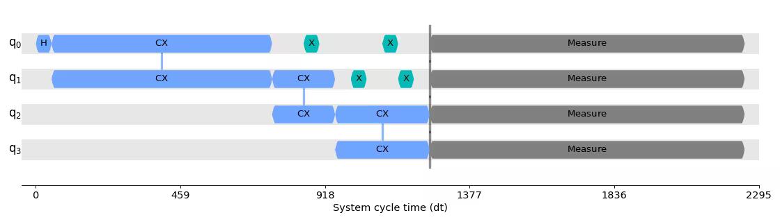

dd_sequence = [XGate(), XGate()]
pm = PassManager([ALAPScheduleAnalysis(durations),
                  PadDynamicalDecoupling(durations, dd_sequence)])
circ_dd = pm.run(circ)
timeline_drawer(circ_dd, target=target)

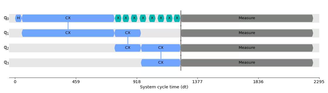

# Uhrig sequence on qubit 0
n = 8
dd_sequence = [XGate()] * n
def uhrig_pulse_location(k):
    return np.sin(np.pi * (k + 1) / (2 * n + 2)) ** 2
spacing = []
for k in range(n):
    spacing.append(uhrig_pulse_location(k) - sum(spacing))
spacing.append(1 - sum(spacing))
pm = PassManager(
        PadDynamicalDecoupling(durations, dd_sequence, qubits=[0], spacing=spacing),
Output from the previous code.Output from the previous code.
