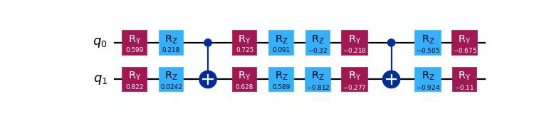

Reference Circuit:
import numpy as np
from qiskit.circuit.library import efficient_su2, unitary_overlap
# get two circuit to prepare states of which we compute the overlap
circuit = efficient_su2(2, reps=1)
unitary1 = circuit.assign_parameters(np.random.random(circuit.num_parameters))
unitary2 = circuit.assign_parameters(np.random.random(circuit.num_parameters))
# create the overlap circuit
overlap = unitary_overlap(unitary1, unitary2)
overlap.draw('mpl')
Circuit diagram output by the previous code.
