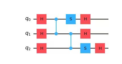

Reference Circuit:
from qiskit.circuit.library import hidden_linear_function
A = [[1, 1, 0], [1, 0, 1], [0, 1, 1]]
circuit = hidden_linear_function(A)
circuit.draw('mpl')
Circuit diagram output by the previous code.
