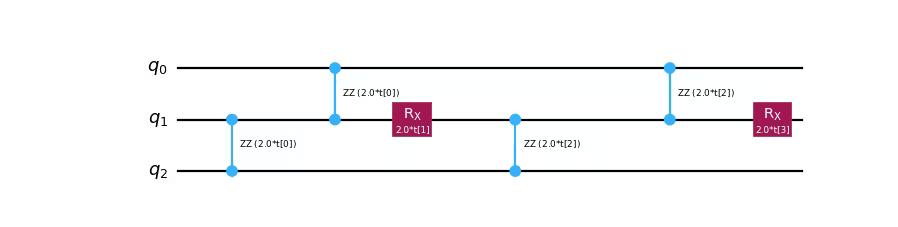

A single operator will be split into commuting terms automatically:
from qiskit.quantum_info import SparsePauliOp
from qiskit.circuit.library import hamiltonian_variational_ansatz
# this Hamiltonian will be split into the two terms [ZZI, IZZ] and [IXI]
hamiltonian = SparsePauliOp(["ZZI", "IZZ", "IXI"])
ansatz = hamiltonian_variational_ansatz(hamiltonian, reps=2)
ansatz.draw("mpl")
Circuit diagram output by the previous code.
