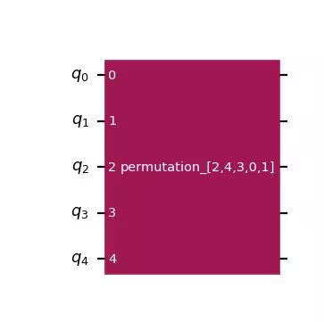

Reference Circuit:
Diagram illustrating the previously described circuit.

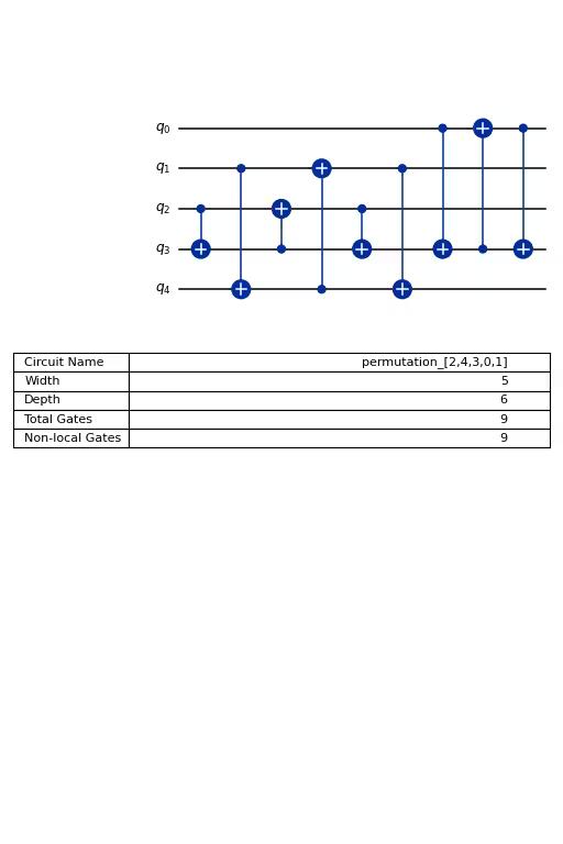

Expanded Circuit:
