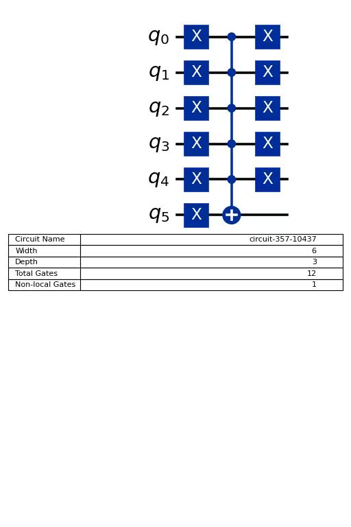

For the OR operation the state 1|1\rangle is interpreted as True. The result qubit is flipped, if the state of any variable qubit is True. The OR is implemented using a multi-open-controlled X gate (i.e. flips if the state is 0|0\rangle) and applying an X gate on the result qubit. Using a list of flags, qubits can be skipped or negated.
The OrGate gate without special flags:
Diagram illustrating the previously described circuit.

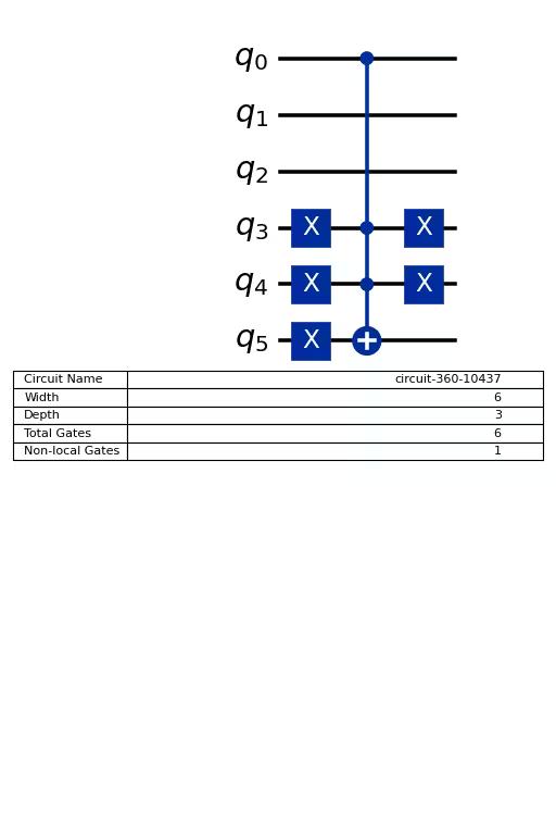

Using flags we can negate qubits or skip them. For instance, if we have 5 qubits and want to return True if the first qubit is False or one of the last two are True we use the flags [-1, 0, 0, 1, 1].
