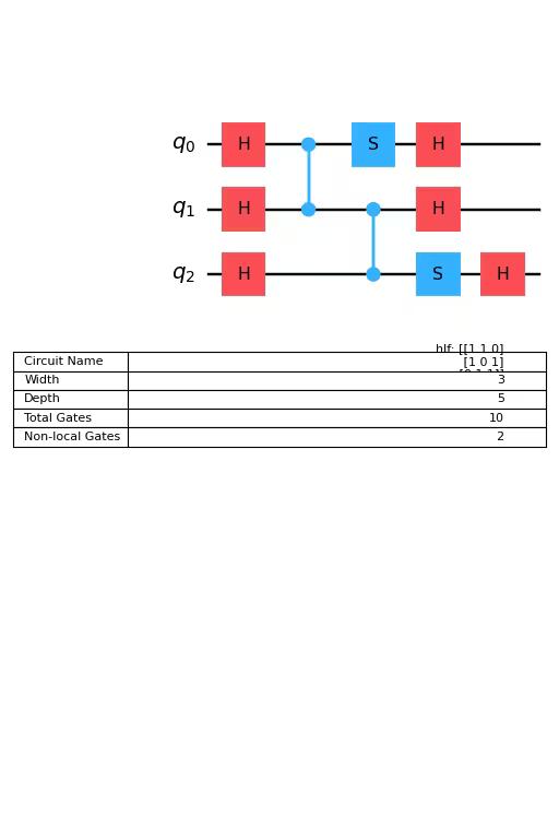

Circuit to solve the hidden linear function problem.
The 2D Hidden Linear Function problem is determined by a 2D adjacency matrix A, where only elements that are nearest-neighbor on a grid have non-zero entries. Each row/column corresponds to one binary variable xix_i.
The hidden linear function problem is as follows:
Consider the quadratic form
q(x)=i,j=1nxixj (mod 4)q(x) = \sum_{i,j=1}^{n}{x_i x_j} ~(\mathrm{mod}~ 4)
and restrict q(x)q(x) onto the nullspace of A. This results in a linear function.
2i=1nzixi (mod 4)xKer(A)2 \sum_{i=1}^{n}{z_i x_i} ~(\mathrm{mod}~ 4) \forall x \in \mathrm{Ker}(A)
and the goal is to recover this linear function (equivalently a vector [z0,...,zn1][z_0, ..., z_{n-1}]). There can be multiple solutions.
In [1] it is shown that the present circuit solves this problem on a quantum computer in constant depth, whereas any corresponding solution on a classical computer would require circuits that grow logarithmically with nn. Thus this circuit is an example of quantum advantage with shallow circuits.
Reference Circuit:
Diagram illustrating the previously described circuit.
Reference:
[1] S. Bravyi, D. Gosset, R. Koenig, Quantum Advantage with Shallow Circuits, 2017. arXiv:1704.00690
