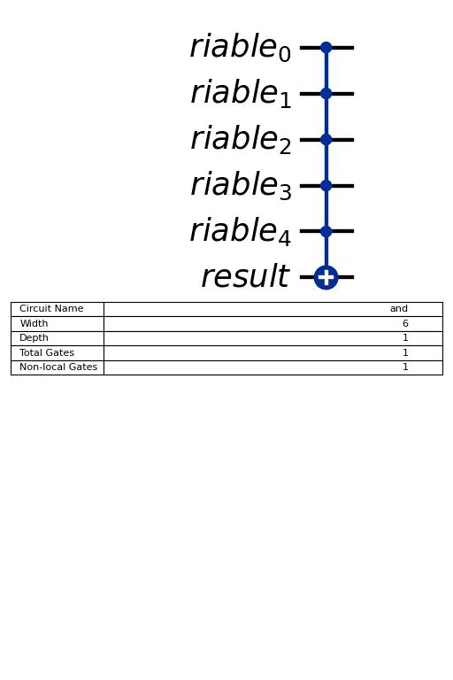

The AND gate without special flags equals the multi-controlled-X gate:
Diagram illustrating the previously described circuit.

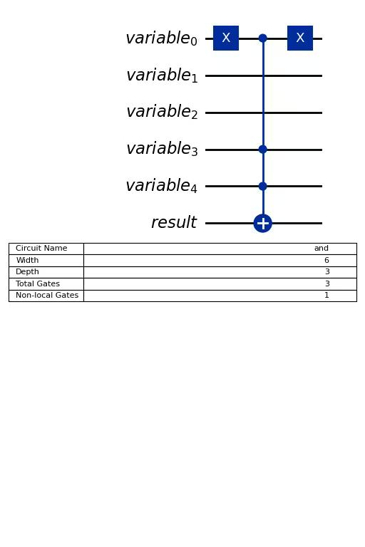

Using flags we can negate qubits or skip them. For instance, if we have 5 qubits and want to return True if the first qubit is False and the last two are True we use the flags [-1, 0, 0, 1, 1].
