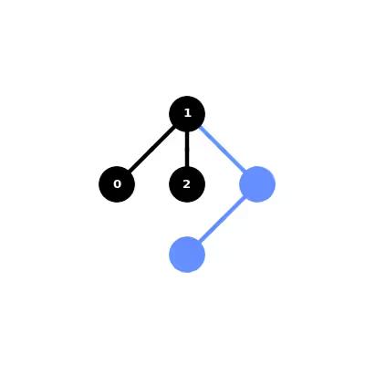

target.build_coupling_map().draw()
This shows the global connectivity of the Target which is the combination of the supported qubits for CXGate and CZGate. To see the individual connectivity, you can pass the operation name to CouplingMap.build_coupling_map():

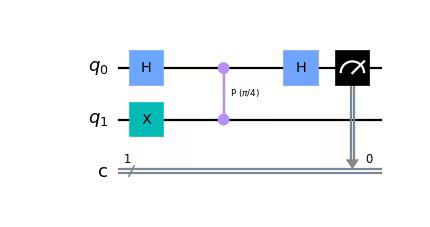

qc = QuantumCircuit(2, 1)
qc.h(0)
qc.x(1)
qc.cp(np.pi/4, 0, 1)
qc.h(0)
qc.measure([0], [0])
qc.draw(output='mpl')
../_images/transpiler-4.png
We have HH, XX, and controlled-PP gates, none of which are in our device’s basis gate set, and thus must be translated. This translation is taken care of for us in the qiskit.execute() function. However, we can transpile the circuit to show what it will look like in the native gate set of the target IBM Quantum device (the FakeVigoV2 backend is a fake backend that models the historical IBM Vigo 5 qubit device for test purposes):

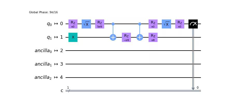

from qiskit import transpile
from qiskit.providers.fake_provider import FakeVigoV2
backend = FakeVigoV2()
qc.h(0)
qc.x(1)
qc.h(0)
qc_basis = transpile(qc, backend)
qc_basis.draw(output='mpl')
../_images/transpiler-5.png
A few things to highlight. First, the circuit has gotten longer with respect to the original. This can be verified by checking the depth of both circuits:
print('Original depth:', qc.depth(), 'Decomposed Depth:', qc_basis.depth())
Original depth: 4 Decomposed Depth: 10
Second, although we had a single controlled gate, the fact that it was not in the basis set means that, when expanded, it requires more than a single CXGate to implement. All said, unrolling to the basis set of gates leads to an increase in the depth of a quantum circuit and the number of gates.

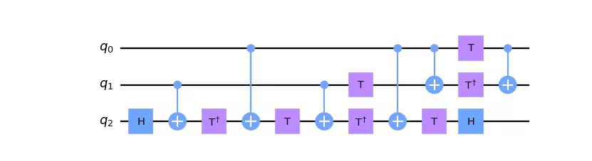

  2. A Toffoli, or controlled-controlled-not gate (ccx), is a three-qubit gate. Given that our basis gate set includes only single- and two-qubit gates, it is obvious that this gate must be decomposed. This decomposition is quite costly:
    ccx_circ = QuantumCircuit(3)
    ccx_circ.ccx(0, 1, 2)
    ccx_circ.decompose().draw(output='mpl')
    ../_images/transpiler-6.png
    For every Toffoli gate in a quantum circuit, the hardware may execute up to six CNOT gates, and a handful of single-qubit gates. From this example, it should be clear that any algorithm that makes use of multiple Toffoli gates will end up as a circuit with large depth and will therefore be appreciably affected by noise and gate errors.

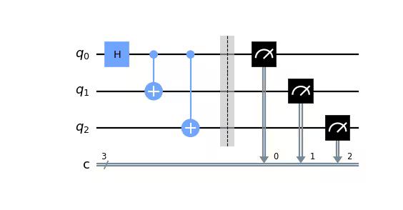

from qiskit import QuantumCircuit, transpile
from qiskit.visualization import plot_circuit_layout
backend = FakeVigo()
ghz = QuantumCircuit(3, 3)
ghz.h(0)
ghz.cx(0,range(1,3))
ghz.barrier()
ghz.measure(range(3), range(3))
ghz.draw(output='mpl')

It is possible to override automatic layout selection by specifying an initial layout. To do so we can pass a list of integers to qiskit.compiler.transpile() via the initial_layout keyword argument, where the index labels the virtual qubit in the circuit and the corresponding value is the label for the physical qubit to map onto:
ghz.h(0)
ghz.barrier()
# Virtual -> physical
#    0    ->    3
#    1    ->    4
#    2    ->    2
my_ghz = transpile(ghz, backend, initial_layout=[3, 4, 2])
plot_circuit_layout(my_ghz, backend)
../_images/transpiler-10.png

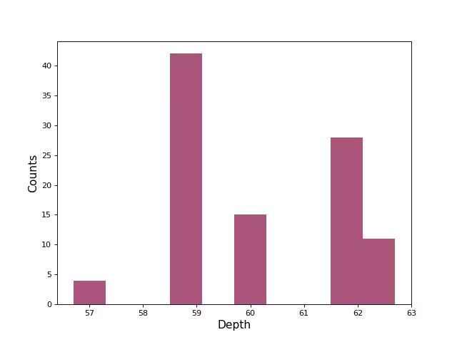

In order to highlight this, we run a GHZ circuit 100 times, using a “bad” (disconnected) initial_layout:
../_images/transpiler-11.png

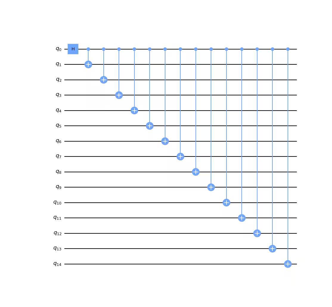

from qiskit.providers.fake_provider import FakeAuckland
backend = FakeAuckland()
ghz = QuantumCircuit(15)
ghz.h(0)
ghz.cx(0, range(1, 15))
depths = []
for _ in range(100):
    depths.append(
        transpile(
            ghz,
            backend,
            layout_method='trivial'  # Fixed layout mapped in circuit order
        ).depth()
plt.figure(figsize=(8, 6))
plt.hist(depths, align='left', color='#AC557C')
plt.xlabel('Depth', fontsize=14)
plt.ylabel('Counts', fontsize=14);
../_images/transpiler-12.png
This distribution is quite wide, signaling the difficulty the swap mapper is having in computing the best mapping. Most circuits will have a distribution of depths, perhaps not as wide as this one, due to the stochastic nature of the default swap mapper. Of course, we want the best circuit we can get, especially in cases where the depth is critical to success or failure. The SabreSwap pass will by default by run its algorithm in parallel with multiple seed values and select the output which uses the fewest swaps. If you would like to increase the number of trials SabreSwap runs you can refer to Working with Preset Pass Managers and modify the routing stage with a custom instance of SabreSwap with a larger value for the trials argument.
Typically, following the swap mapper, the routing stage in the preset pass managers also includes running the VF2PostLayout pass. As its name implies, VF2PostLayout uses the same basic algorithm as VF2Layout, but instead of using it to find a perfect initial layout, it is designed to run after mapping and try to find a layout on qubits with lower error rates which will result in better output fidelity when running the circuit. The details of this algorithm are described in arXiv:2209.15512.

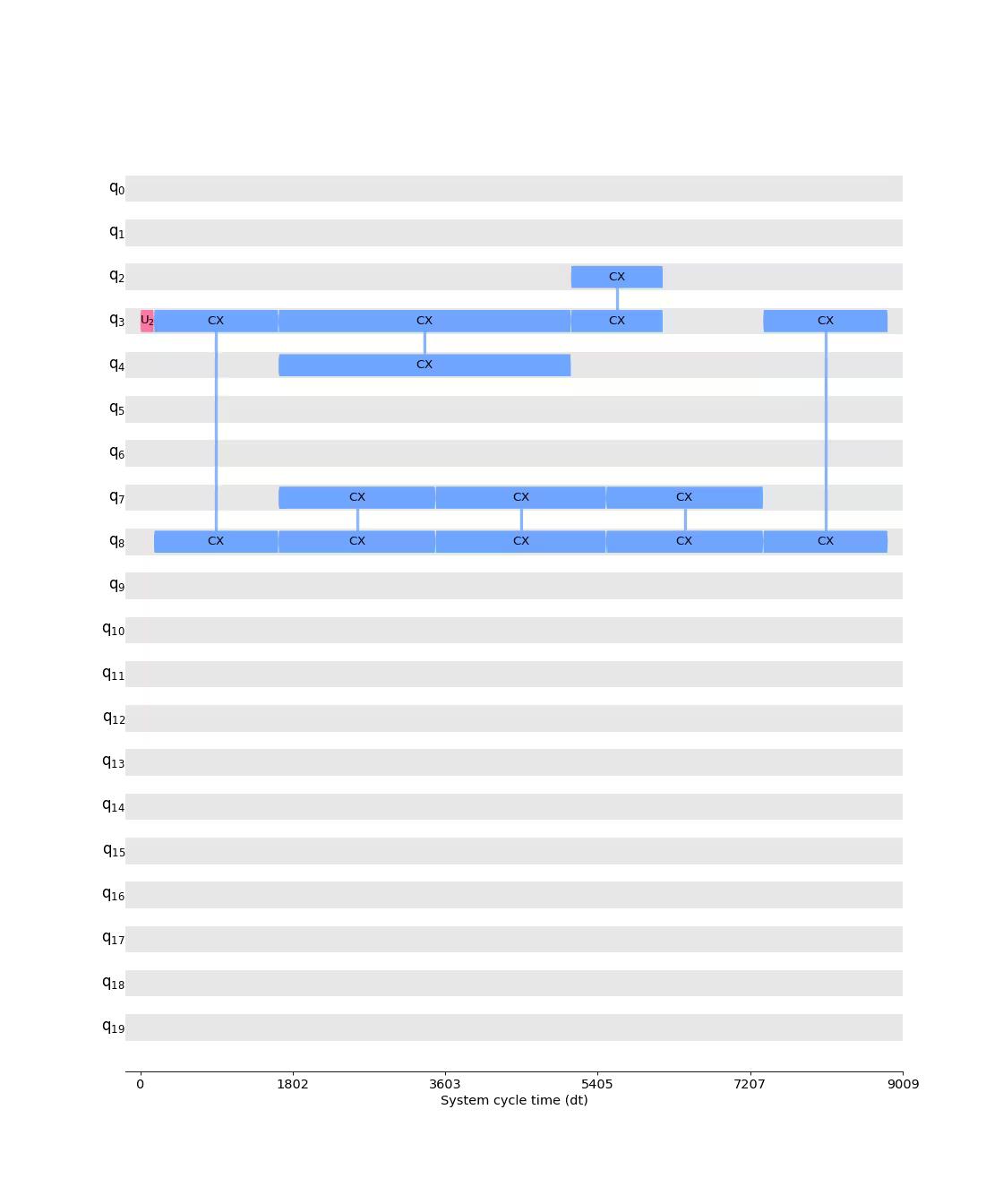

Scheduling Stage
After the circuit has been translated to the target basis, mapped to the device, and optimized, a scheduling phase can be applied to optionally account for all the idle time in the circuit. At a high level the scheduling can be thought of as inserting delays into the circuit to account for idle time on the qubits between the execution of instructions. For example, if we start with a circuit such as:
../_images/transpiler-15.png
we can then call transpile() on it with scheduling_method set:
from qiskit.providers.fake_provider import FakeBoeblingen
backend = FakeBoeblingen()

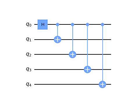

ghz = QuantumCircuit(5)
ghz.h(0)
ghz.cx(0,range(1,5))

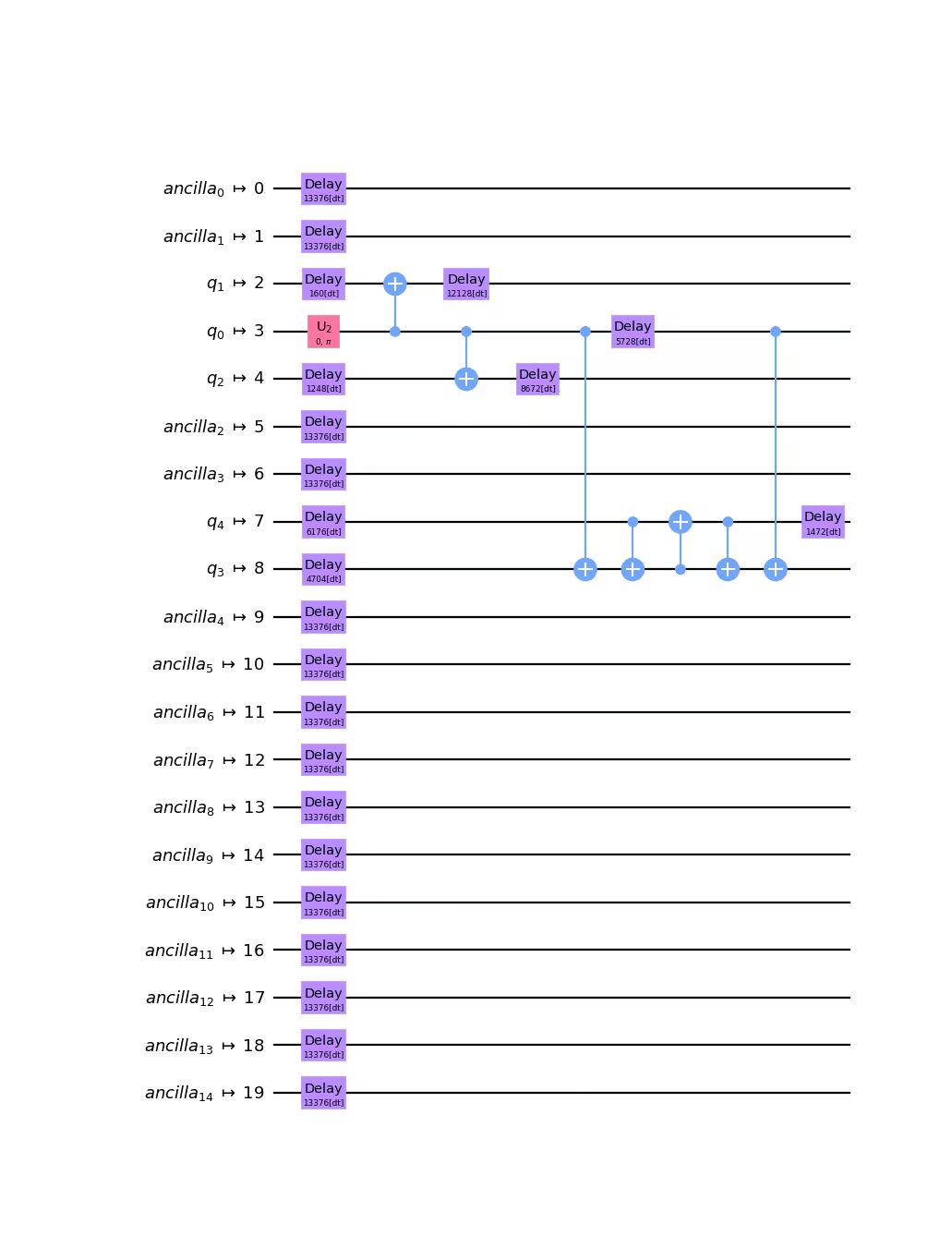

circ = transpile(ghz, backend, scheduling_method="asap")
circ.draw(output='mpl')
../_images/transpiler-16.png
You can see here that the transpiler inserted Delay instructions to account for idle time on each qubit. To get a better idea of the timing of the circuit we can also look at it with the timeline.draw() function:
