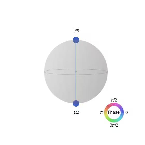

from qiskit.quantum_info import Statevector
from qiskit.visualization import plot_state_qsphere
qc = QuantumCircuit(2)
qc.h(0)
qc.cx(0, 1)
state = Statevector(qc)
plot_state_qsphere(state)
../_images/qiskit-visualization-plot_state_qsphere-1.png

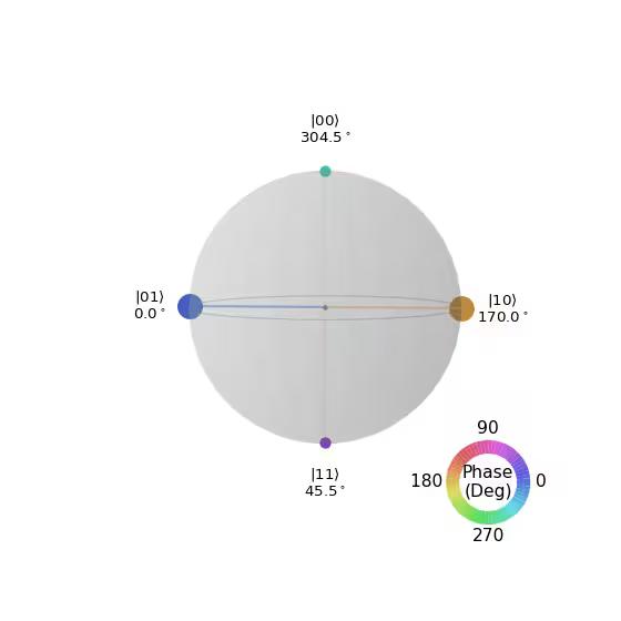

# You can show the phase of each state and use
# degrees instead of radians
from qiskit.quantum_info import DensityMatrix
import numpy as np
qc.h([0, 1])
qc.cz(0,1)
qc.ry(np.pi/3, 0)
qc.rx(np.pi/5, 1)
qc.z(1)
matrix = DensityMatrix(qc)
plot_state_qsphere(matrix,
     show_state_phases = True, use_degrees = True)
../_images/qiskit-visualization-plot_state_qsphere-2.png
