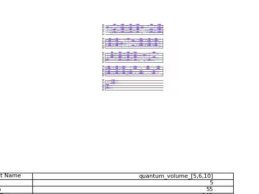

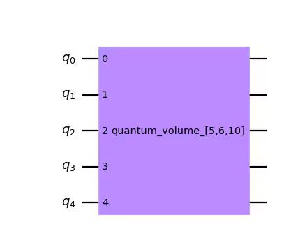

A quantum volume model circuit.
The model circuits are random instances of circuits used to measure the Quantum Volume metric, as introduced in [1].
The model circuits consist of layers of Haar random elements of SU(4) applied between corresponding pairs of qubits in a random bipartition.
Reference Circuit:
../_images/qiskit-circuit-library-QuantumVolume-1.png
Expanded Circuit:
../_images/qiskit-circuit-library-QuantumVolume-2.png
References:
[1] A. Cross et al. Validating quantum computers using randomized model circuits, Phys. Rev. A 100, 032328 (2019). [arXiv:1811.12926]
