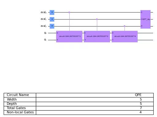

Phase Estimation circuit.
In the Quantum Phase Estimation (QPE) algorithm [1, 2, 3], the Phase Estimation circuit is used to estimate the phase ϕ\phi of an eigenvalue e2πiϕe^{2\pi i\phi} of a unitary operator UU, provided with the corresponding eigenstate psi|psi\rangle. That is
Uψ=e2πiϕψU|\psi\rangle = e^{2\pi i\phi} |\psi\rangle
This estimation (and thereby this circuit) is a central routine to several well-known algorithms, such as Shor’s algorithm or Quantum Amplitude Estimation.

Parameters
  • num_evaluation_qubits (int) – The number of evaluation qubits.
  • unitary (QuantumCircuit) – The unitary operation UU which will be repeated and controlled.
  • iqft (QuantumCircuit | None) – A inverse Quantum Fourier Transform, per default the inverse of QFT is used. Note that the QFT should not include the usual swaps!
  • name (str) – The name of the circuit.
Note
The inverse QFT should not include a swap of the qubit order.
Reference Circuit:
../_images/qiskit-circuit-library-PhaseEstimation-1.png
