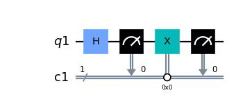

Now, we add an XGate only if the value of the ClassicalRegister is 0. That way, if the state is 0|0\rangle, it will be changed to 1|1\rangle and if the state is 1|1\rangle, it will not be changed at all, so the final state will always be 1|1\rangle.
from qiskit import BasicAer, transpile, QuantumRegister, ClassicalRegister, QuantumCircuit
qr = QuantumRegister(1)
cr = ClassicalRegister(1)
qc = QuantumCircuit(qr, cr)
qc.h(0)
qc.measure(0, 0)
qc.x(0).c_if(cr, 0)
qc.measure(0, 0)
qc.draw('mpl')
../_images/circuit-3.png
backend = BasicAer.get_backend('qasm_simulator')
tqc = transpile(qc, backend)
counts = backend.run(tqc).result().get_counts()
print(counts)
{'1': 1024}

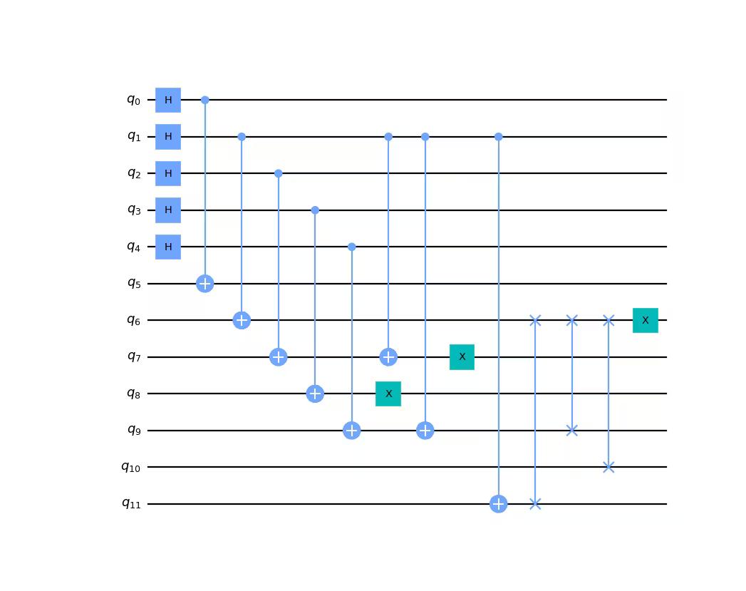

Consider the following circuit:
qc = QuantumCircuit(12)
for idx in range(5):
   qc.h(idx)
   qc.cx(idx, idx+5)
qc.cx(1, 7)
qc.x(8)
qc.cx(1, 9)
qc.x(7)
qc.cx(1, 11)
qc.swap(6, 11)
qc.swap(6, 9)
qc.swap(6, 10)
qc.x(6)
qc.draw('mpl')
../_images/circuit-4.png
From the plot, it is easy to see that this circuit has 12 qubits, and a collection of Hadamard, CNOT, X, and SWAP gates. But how to quantify this programmatically? Because we can do single-qubit gates on all the qubits simultaneously, the number of qubits in this circuit is equal to the width of the circuit:
qc.width()
12
We can also just get the number of qubits directly:
qc.num_qubits
12

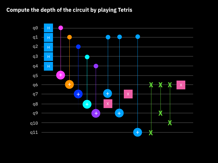

A particularly important circuit property is known as the circuit depth. The depth of a quantum circuit is a measure of how many “layers” of quantum gates, executed in parallel, it takes to complete the computation defined by the circuit. Because quantum gates take time to implement, the depth of a circuit roughly corresponds to the amount of time it takes the quantum computer to execute the circuit. Thus, the depth of a circuit is one important quantity used to measure if a quantum circuit can be run on a device.
The depth of a quantum circuit has a mathematical definition as the longest path in a directed acyclic graph (DAG). However, such a definition is a bit hard to grasp, even for experts. Fortunately, the depth of a circuit can be easily understood by anyone familiar with playing Tetris. Lets see how to compute this graphically:
../_images/depth.gif
We can verify our graphical result using QuantumCircuit.depth():
qc.depth()
9
