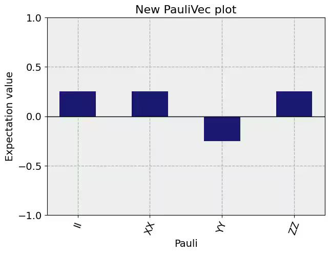

# You can set a color for all the bars.
from qiskit.quantum_info import Statevector
from qiskit.visualization import plot_state_paulivec
qc = QuantumCircuit(2)
qc.h(0)
qc.cx(0, 1)
state = Statevector(qc)
plot_state_paulivec(state, color='midnightblue', title="New PauliVec plot")
../_images/qiskit.visualization.plot_state_paulivec_0_0.png

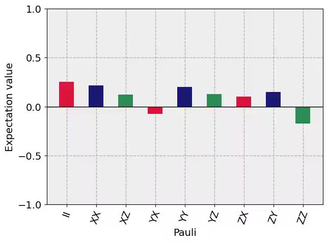

# If you introduce a list with less colors than bars, the color of the bars will
# alternate following the sequence from the list.
import numpy as np
from qiskit.quantum_info import DensityMatrix
qc.h([0, 1])
qc.cz(0, 1)
qc.ry(np.pi/3, 0)
qc.rx(np.pi/5, 1)
matrix = DensityMatrix(qc)
plot_state_paulivec(matrix, color=['crimson', 'midnightblue', 'seagreen'])
../_images/qiskit.visualization.plot_state_paulivec_1_0.png
