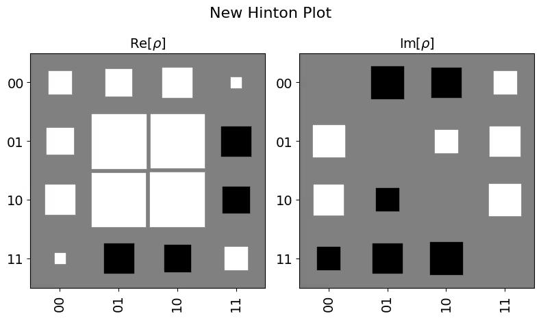

Plot a hinton diagram for the density matrix of a quantum state.
The hinton diagram represents the values of a matrix using squares, whose size indicate the magnitude of their corresponding value and their color, its sign. A white square means the value is positive and a black one means negative.

Examples
import numpy as np
from qiskit.quantum_info import DensityMatrix
from qiskit.visualization import plot_state_hinton
qc = QuantumCircuit(2)
qc.h([0, 1])
qc.cz(0,1)
qc.ry(np.pi/3 , 0)
qc.rx(np.pi/5, 1)
state = DensityMatrix(qc)
plot_state_hinton(state, title="New Hinton Plot")
../_images/qiskit.visualization.plot_state_hinton_0_0.png
