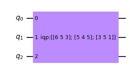

../_images/qiskit.circuit.library.IQP_0_0.png
