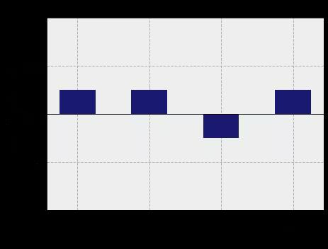

Example
from qiskit.quantum_info import Statevector
from qiskit.visualization import plot_state_paulivec
%matplotlib inline
qc = QuantumCircuit(2)
qc.h(0)
qc.cx(0, 1)
state = Statevector.from_instruction(qc)
plot_state_paulivec(state, color='midnightblue',
     title="New PauliVec plot")
../_images/qiskit.visualization.plot_state_paulivec_0_0.png
