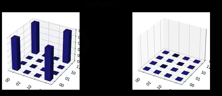

Example
from qiskit.quantum_info import DensityMatrix
from qiskit.visualization import plot_state_city
%matplotlib inline
qc = QuantumCircuit(2)
qc.h(0)
qc.cx(0, 1)
state = DensityMatrix.from_instruction(qc)
plot_state_city(state, color=['midnightblue', 'midnightblue'],
     title="New State City")
../_images/qiskit.visualization.plot_state_city_0_0.png
