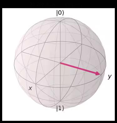

Example
from qiskit.visualization import plot_bloch_vector
%matplotlib inline
plot_bloch_vector([0,1,0], title="New Bloch Sphere")
../_images/qiskit.visualization.plot_bloch_vector_0_0.png
