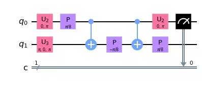

We have HH, XX, and controlled-PP gates, all of which are not in our devices basis gate set, and must be expanded. This expansion is taken care of for us in the qiskit.execute() function. However, we can decompose the circuit to show what it would look like in the native gate set of the IBM Quantum devices:
qc_basis = qc.decompose()
qc_basis.draw(output='mpl')
../_images/transpiler_3_0.png
A few things to highlight. First, the circuit has gotten longer with respect to the initial one. This can be verified by checking the depth of the circuits:
print('Original depth:', qc.depth(), 'Decomposed Depth:', qc_basis.depth())
Original depth: 4 Decomposed Depth: 7

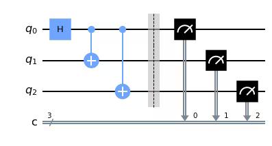

ghz = QuantumCircuit(3, 3)
ghz.h(0)
ghz.cx(0,range(1,3))
ghz.barrier()
ghz.measure(range(3), range(3))
ghz.draw(output='mpl')
../_images/transpiler_7_0.png

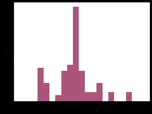

In order to highlight this, we run a GHZ circuit 100 times, using a “bad” (disconnected) initial_layout:
from qiskit import QuantumCircuit, transpile
from qiskit.test.mock import FakeBoeblingen
backend = FakeBoeblingen()

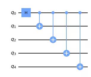

ghz = QuantumCircuit(5)
ghz.h(0)
ghz.cx(0,range(1,5))
../_images/transpiler_11_0.png
depths = []
for _ in range(100):
   depths.append(transpile(ghz,
                           backend,
                           initial_layout=[7, 0, 4, 15, 19],
                          ).depth())
plt.figure(figsize=(8, 6))
plt.hist(depths, bins=list(range(14,36)), align='left', color='#AC557C')
plt.xlabel('Depth', fontsize=14)
plt.ylabel('Counts', fontsize=14);
../_images/transpiler_12_0.png
This distribution is quite wide, signaling the difficultly the SWAP mapper is having in computing the best mapping. Most circuits will have a distribution of depths, perhaps not as wide as this one, due to the stochastic nature of the default SWAP mapper. Of course, we want the best circuit we can get, especially in cases where the depth is critical to success or failure. In cases like this, it is best to transpile() a circuit several times, e.g. 10, and take the one with the lowest depth. The transpile() function will automatically run in parallel mode, making this procedure relatively speedy in most cases.
ghz.h(0)
../_images/transpiler_13_0.png
