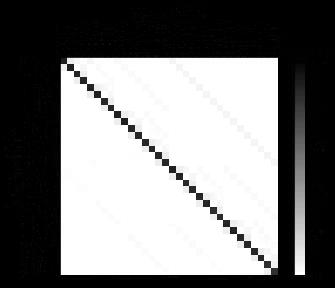

# Plot fitted N-qubit assignment matrix
mitigator.plot_assignment_matrix()
<AxesSubplot:xlabel='Prepared State', ylabel='Measured State'>
../_images/qiskit.ignis.mitigation.expval_meas_mitigator_circuits_0_2.png
