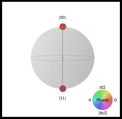

Plot the qsphere representation of a quantum state. Here, the size of the points is proportional to the probability of the corresponding term in the state and the color represents the phase.

Example
from qiskit.quantum_info import Statevector
from qiskit.visualization import plot_state_qsphere
%matplotlib inline
qc = QuantumCircuit(2)
qc.h(0)
qc.cx(0, 1)
state = Statevector.from_instruction(qc)
plot_state_qsphere(state)
../_images/qiskit.visualization.plot_state_qsphere_0_0.png ../_images/qiskit.visualization.plot_state_qsphere_0_1.png
