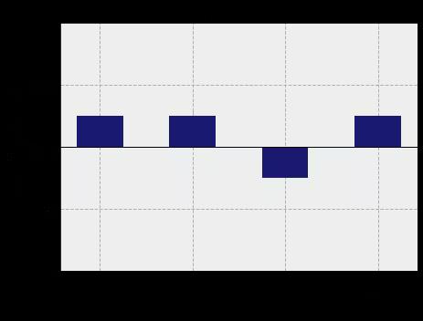

Plot the paulivec representation of a quantum state.
Plot a bargraph of the mixed state rho over the pauli matrices
Parameters
  • state (Statevector orDensityMatrix or ndarray) – an N-qubit quantum state.
  • title (str) – a string that represents the plot title
  • figsize (tuple) – Figure size in inches.
  • color (list or str) – Color of the expectation value bars.
  • ax (matplotlib.axes.Axes) – An optional Axes object to be used for the visualization output. If none is specified a new matplotlib Figure will be created and used. Additionally, if specified there will be no returned Figure since it is redundant.
Returns
The matplotlib.Figure of the visualization if the ax kwarg is not set
Return type
matplotlib.Figure
Raises
  • ImportError – Requires matplotlib.
  • VisualizationError – if input is not a valid N-qubit state.
Example
from qiskit.quantum_info import Statevector
from qiskit.visualization import plot_state_paulivec
%matplotlib inline
qc = QuantumCircuit(2)
qc.h(0)
qc.cx(0, 1)
state = Statevector.from_instruction(qc)
plot_state_paulivec(state, color='midnightblue',
     title="New PauliVec plot")
../_images/qiskit.visualization.plot_state_paulivec_0_0.png ../_images/qiskit.visualization.plot_state_paulivec_0_1.png
