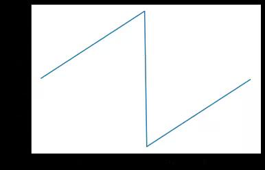

sawtooth
sawtooth(duration, amp, freq=None, phase=0, name=None)
GitHub
Generates sawtooth wave Waveform.
For A=A= amp, T=T= period, and ϕ=\phi= phase, applies the midpoint sampling strategy to generate a discrete pulse sampled from the continuous function:
f(x)=2A(g(x)12+g(x))f(x) = 2 A \left( g(x) - \left\lfloor \frac{1}{2} + g(x) \right\rfloor\right)
where g(x)=x/T+ϕ/πg(x) = x/T + \phi/\pi.
Parameters
  • duration (int) – Duration of pulse. Must be greater than zero.
  • amp (complex) – Pulse amplitude. Wave range is [[- amp ,, amp ]].
  • freq (Optional[float]) – Pulse frequency, units of 1./dt. If None defaults to 1./duration.
  • phase (float) – Pulse phase.
  • name (Optional[str]) – Name of pulse.
Example
from qiskit.pulse.library import sawtooth
import numpy as np
duration = 100
amp = 1
freq = 1 / duration
sawtooth_wave = np.real(sawtooth(duration, amp, freq).samples)
plt.plot(range(duration), sawtooth_wave)
[<matplotlib.lines.Line2D at 0x7f47cc2fe090>]
../_images/qiskit.pulse.library.discrete_0_1.png

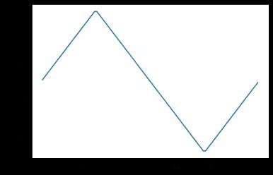

triangle
triangle(duration, amp, freq=None, phase=0, name=None)
GitHub
Generates triangle wave Waveform.
f(x)=A(2sawtooth(x,A,T,ϕ)+1)f(x) = A \left(-2\left|\text{sawtooth}(x, A, T, \phi)\right| + 1\right)
This a non-sinusoidal wave with linear ramping.
Parameters
Example
from qiskit.pulse.library import triangle
import numpy as np
duration = 100
amp = 1
freq = 1 / duration
triangle_wave = np.real(triangle(duration, amp, freq).samples)
plt.plot(range(duration), triangle_wave)
[<matplotlib.lines.Line2D at 0x7f47cbe3a790>]
../_images/qiskit.pulse.library.discrete_1_1.png
