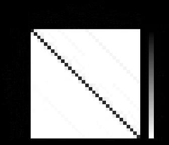

# Plot fitted N-qubit assignment matrix
mitigator.plot_assignment_matrix()
<matplotlib.axes._subplots.AxesSubplot at 0x7f6e48f19490>
