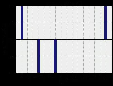

Example
from qiskit import QuantumCircuit, BasicAer, execute
from qiskit.visualization import plot_state_paulivec
%matplotlib inline
qc = QuantumCircuit(2, 2)
qc.h(0)
qc.cx(0, 1)
qc.measure([0, 1], [0, 1])
backend = BasicAer.get_backend('statevector_simulator')
job = execute(qc, backend).result()
plot_state_paulivec(job.get_statevector(qc), color='midnightblue',
     title="New PauliVec plot")
../_images/qiskit.visualization.plot_state_paulivec_0_3.png ../_images/qiskit.visualization.plot_state_paulivec_0_4.png
